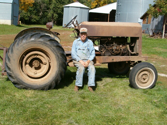

This is my Father-in-law on a tractor ( doodlebug ) he made in 1952. Chevy 216 engine, 4 speed transmission going into a 3 speed trans.
Two speed International differential made this a 24 speed and 12 reverse tractor. Reversible PTO works good on the hydraulic 3 point on it when digging postholes. He has had it well above 55 mph only once! He once said there is no man alive who could drive it as fast as it can go! Max Armstrong with the old Farm Report did a segment with him. By the way, the tractors name is Sam
