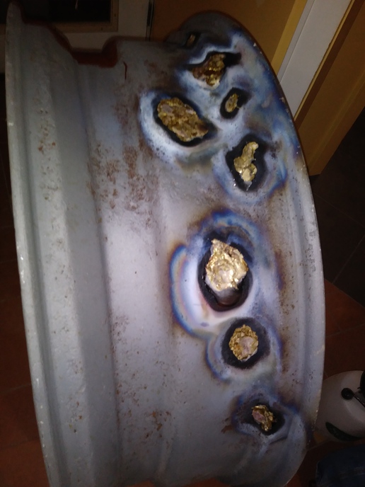

Some guys complain cause they only got 20
or 40 or 80 years out of a set of rims 'due
to calcium'.
I sometimes wonder if they also complain
cause they only got 10K hours on a set of
rod bearings.
Rims, like tires, rod bearings, mufflers,
tie rod ends, etc are perishable items.

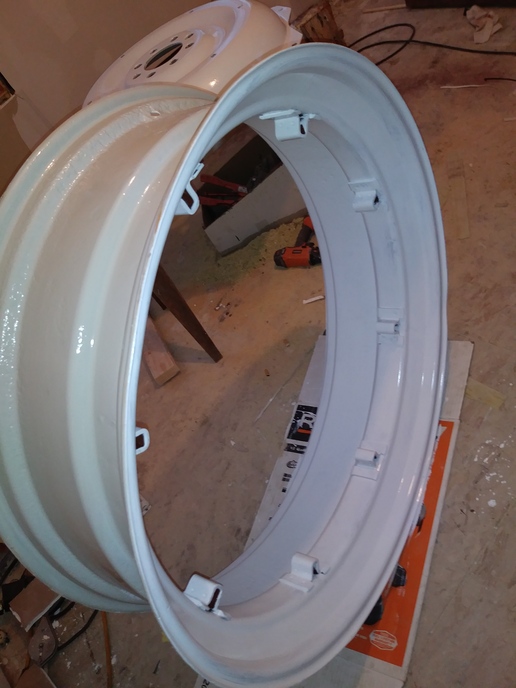

The rim below was 52 years old when
I had to rehab it a few years ago.
After sandblasting, a bit of brazing, a
good coat of primer and 2 coats of paint,
it will likely go another 50 years.
When I finished fixing it I pumped the
calcium back in. Because despite the
problems it can cause - usually due to lack
of maintenance - it is still the best bang
for your buck.
