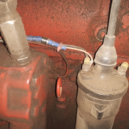

My jubilee was doing the same thing and there was no way to bypass the ballast. So I connected the cathode end of a diode, the white
stripe, to the coil. The other end of the diode is connected to the starter's power wire.. it works fine now..
Your battery's cranking voltage is less than it should be.
Might check out the condition of the battery.
