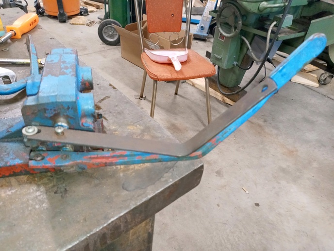

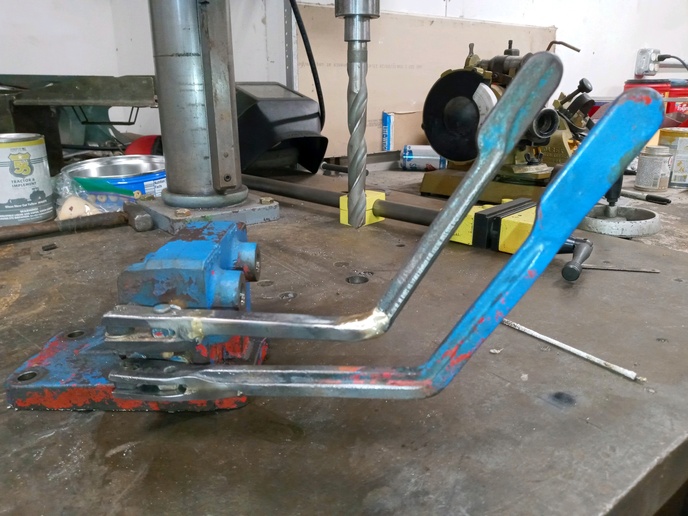

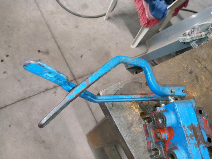

I woke up thinking about doing these handles this morning.
This Ford dual remote valve had very poor handles on it. The lower one was broken and the upper one was just a piece of flat bar that someone had crudely added.
Replacement handles for these are made of unobtainium.
I had saved this handle from a different valve for years. Obviously it wouldn't work but the pivot did fit on this valve.
So I chopped it apart, brazed in a piece of steel and made a handle to fit.
I also repaired the lower handle so it is good again.
It ain't so pretty but it is once again, suitable for everyday use.
