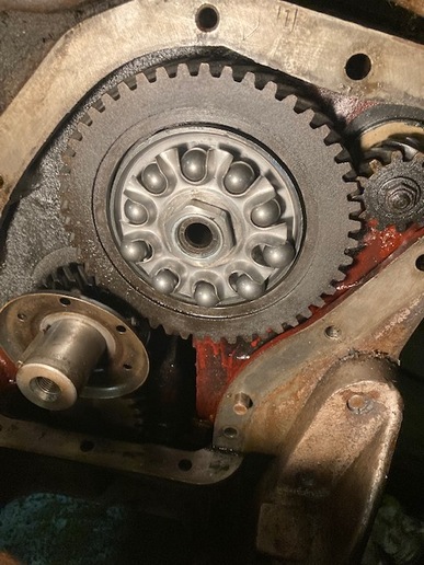

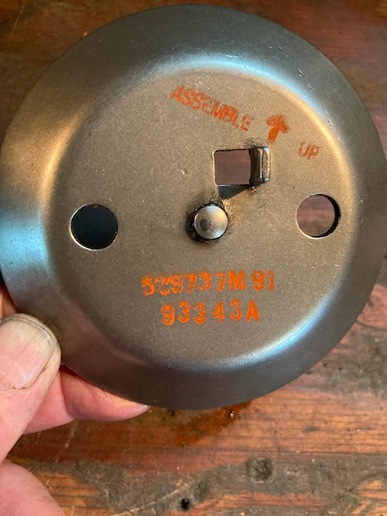

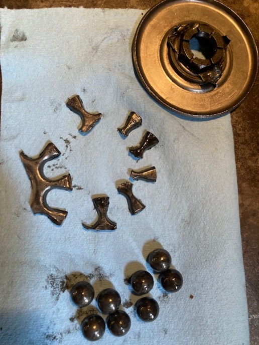

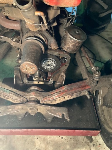

The MF35 started surging and over reving so finally I suspected the governor. The first picture shows what was left after fishing them out of the oil pan. I made a gasket but decided to wait for a new one I ordered. I drained the oil and changed the filter. The third picture shows the umbrella that is put over the governor. Previous posts and repair videos indicate the tab location at 8:00 oclock. But this umbrella was from a repair 15 years ago and the direction is on it. I think I will follow that. Do you guys put any thing on the gasket when installing the timing cover? Also, the lock nut holding the bearings can only be tightened so much...its not flush against the gear but I don't want break the end of the cam. Its about 1/16th clearance. Hope it works and I welcome any advice for the repair. Thanks. Will be using the Ford 3000 giving the MF35 a rest.
