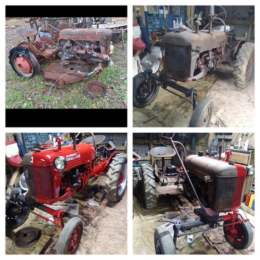

Saved this one......all I did when I got it home was new wires and distributor cap, temporary gas tank and good battery,it fired right up. Then I changed fluids and gave it a tune up. leaks here and there.... But use it at least once a week

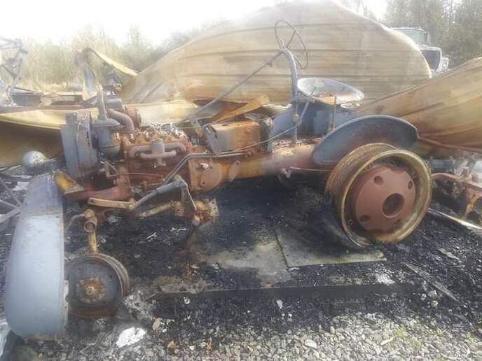

Front tires burnt off, backs half gone. All oils were still fluid. Wires had the coating melted off but wires were not burnt off..... Aluminum parts ( carb, radiator, magneto, hydraulic pump) were not melted.
This one had very few good parts on it... Most parts I didn't even try to use. It got way too hot. Melted all the aluminum parts.
