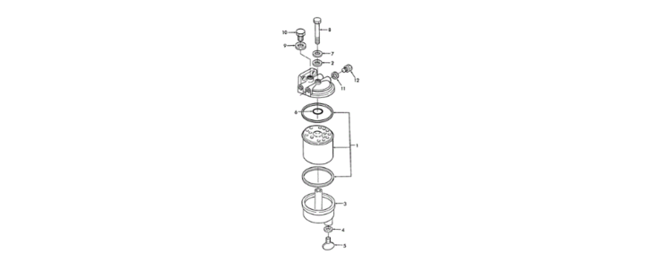

Re: New Holland L455, Kabota D1402 Fuel filter replacement
Posted by onefarmer on May 27, 2022 at 11:34:15 from (50.105.72.123):
In Reply to: New Holland L455, Kabota D1402 Fuel filter replacement posted by Kips on May 27, 2022 at 09:32:48:
If it's like mine it's assembled like a sandwich. You got the housing at the top, then the filter, and a bowl on the bottom. There's a hex head bolt on top, 7/16th wrench I think, that goes from the top to the bottom to hold it all together. See the picture taken from Messicks.
