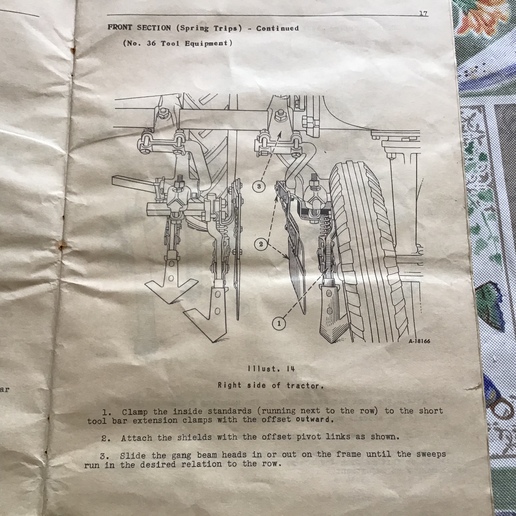

This is from manual for c 244
Do you have rear section?
Be very careful you dont lift shank to high and put the shank thru oil pan ! Set the touch levers stops so you dont !
