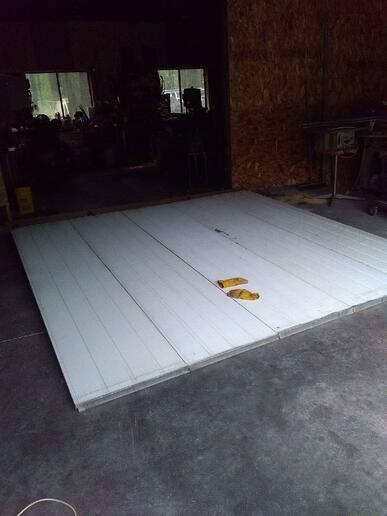

Mine is designed as a 10x10 slider. I kept an eye on Clist, and found five 2 inch aluminum clad insulated panels, 2' x 10' from a used overhead door. They are solid core insulation. I welded 5 of them together, top and bottom (they have riveted galvanized on each end), and am in the process of attaching a light gauge steel channel to the top to attach my rollers. Well insulated, and weather proof panel. steve
