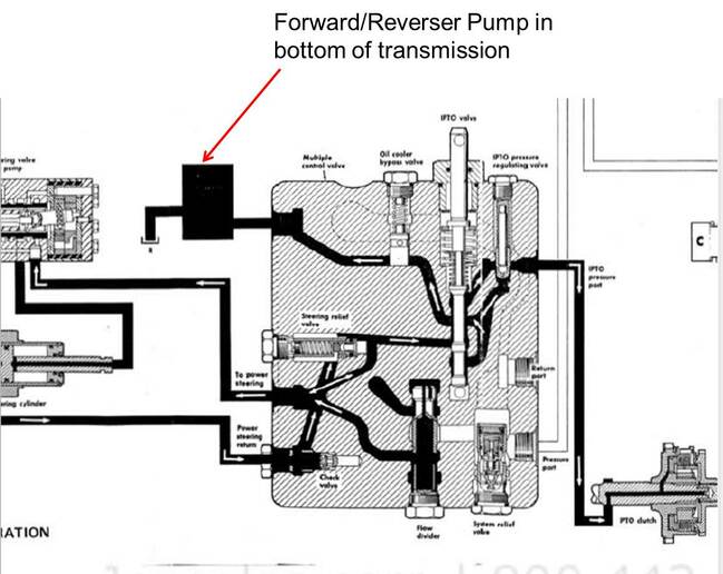

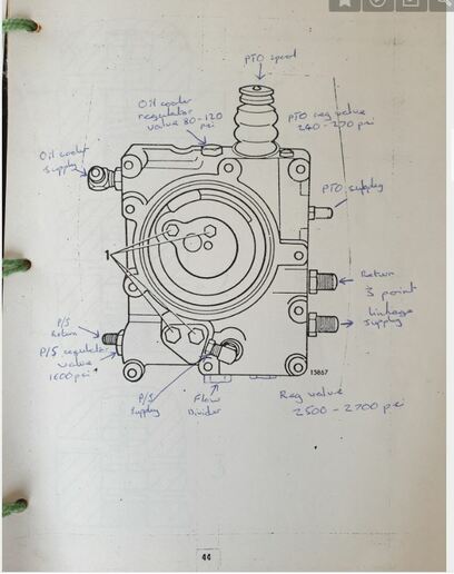

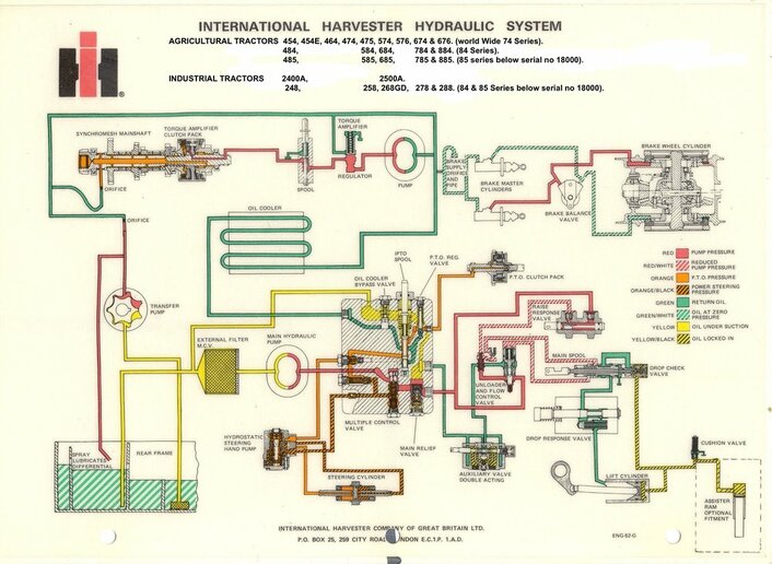

Hi, if you don't have the service manuals they can be downloaded for free from the link below.
There is a complete section 10 of the service manual covers the hydraulic system including trouble shooting and symptoms and causes section.
Make sure you have no air leaks around the hydraulic filter housing. I assume you have plenty of oil in the hydraulic/trans/diff.
Re Power Steering, could be the Flow Divider is stuck in the bore in the MCV or the PS relief valve spring is broken.
The purpose of the flow divider is to split the 12 GPM output of the pump into 3 GPM for PS and 9 GPM for 3pt and remotes.
If the flow divider sticks in the bottom of the bore then too much oil will go to 3pt and not enough to PS and when stuck in the top of the bore then too much to PS and not enough to 3pt.
Re Brakes, could be leaking brake O-rings in axle or not enough hydraulic oil flow from the return side of the oil cooler which is related to poort oil flow to PS.
See the photos below of hydraulic flow through the MCV, one photo shows the flow if your 2500B has the hydraulic FWD/REV option.
