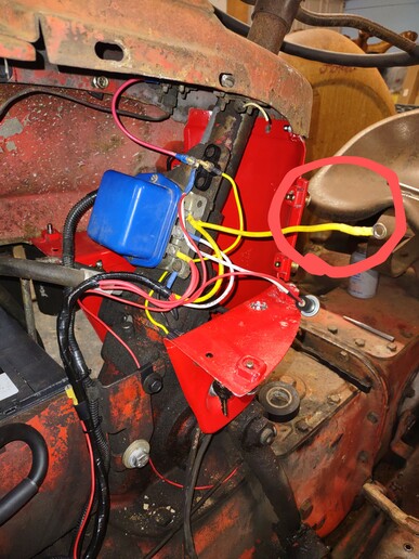

I have rewired my tractor and now I'm at a
stop. The fat yellow that's circled does
that get hooked to the terminal block or
straight to the ammeter? Cause the
instructions that came with the wiring
harness shows it going to the terminal
block and another drawing I got from this
site shows it going to the ammeter and
another wire from the ammeter to the
terminal block. Which is correct? Also
when I do hook the ammeter up with two
wires separate wires the yellow wire to
the terminal block I get a discharge and
when I switched the separate wires I get a
charge this is with the tractor not
running. Should the ammeter always have
power to it with the key off or do I need
to add a third wire from the ammeter?
