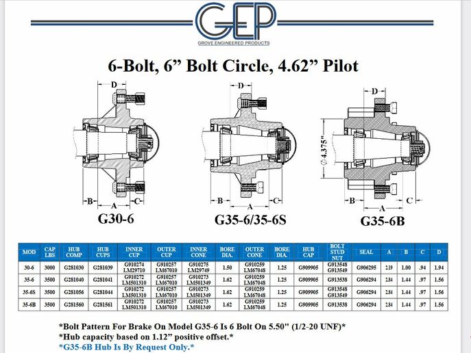

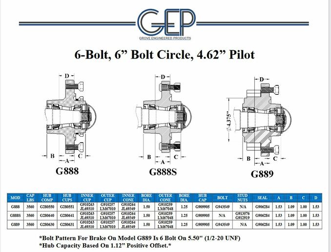

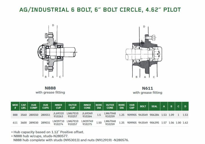

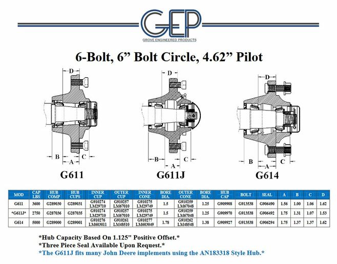

Okay, just realized you stated six bolt in topic title. Some six bolt hubs with 1.50 and 1.25 bearings are seen in pictures attached .
