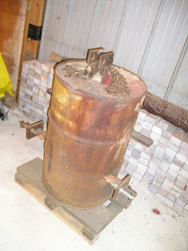

A 55 gallon barrel works great. Run the lower links through the front third (not in the middle) of the barrel to allow for clearance without moving/removing the drawbar. Add a hitch on the back and place another horizontal bar in the back third of the barrel in case one needs additional weight (via front end suitcase weights) for a different tractor down the road. This will be about 1,200 pounds. Fill part way with concrete and finish with gravel, etc. Remember in this setup water will rust out the barrel eventually. I filled mine with 1 inch of top with concrete. This left room for a chain, etc. on top with little chance of it falling off and getting lost.
