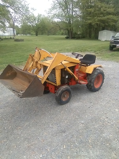

Case 646 back to life
Posted by J Hamilton on May 06, 2022 at 09:45:46 from (174.250.211.244):
I thought it was the engine that went BANG while just idling. Pulled the engine out to see what happened, couldn't find anything wrong. Next check the hydraulic pump, half turn and stops, turned the opposite way, half turn and stops. Took pump apart to find broken teeth on the gears and badly damaged. After many phone calls and lots of research of part numbers I was able to find a brand new pump that would interchange for only $110. I got lucky on that. After a very good cleaning and flushing of the hydraulic system, it's all back together and working great.
