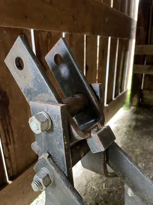

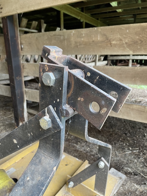

Here are some photos of the modified U linkage, so that it
flexes up, instead of down. There are two pieces welded on.
One bar across the front bottom, so the U linkage is always
slightly up, and a tab on the back, to keep it from over
rotating towards the back.
