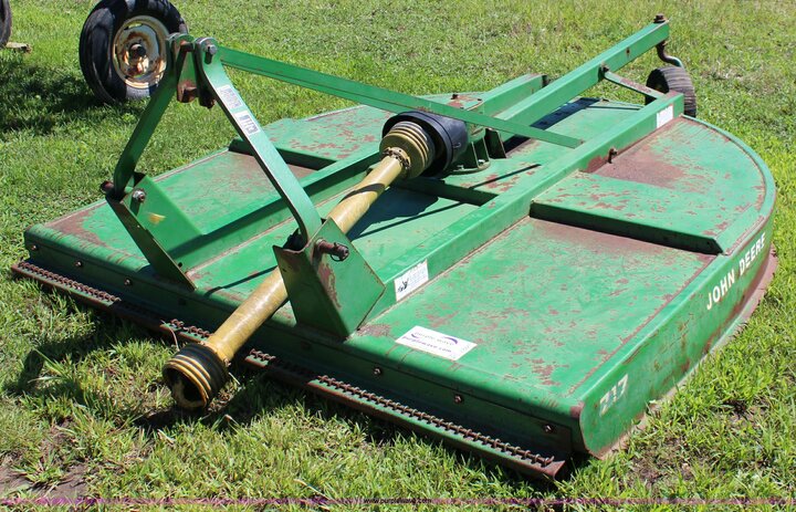

Your wanting to let the rear of your cutter float up and down while on the ground with a limited amount of travel. An easy way to do this is to install two short flat irons with a hole in each end, in the current top link pin location of the cutter. Then you install your top link to the one set of holes. So when lifting the cutter the irons act just like the top link does. However when in the mowing position the irons will drop and allow movement when in compression. The length of the irons will limit the total movement. This does the same thing as the chain in pipe idea but is easier to hookup.
