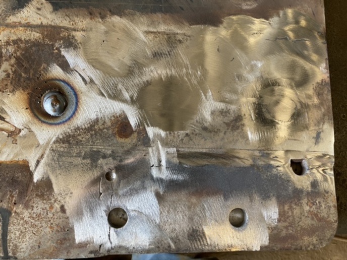

I have a Waldon blade on my Oliver 1850. I knew it was sprung when I bought it but I made mounts and put it on anyway. When using it, the right side is about 3higher than the left side. I took the mounting plate off of one side and welded the holes shut so I can try to twist the frame enough to get it close to level and then drill new holes.

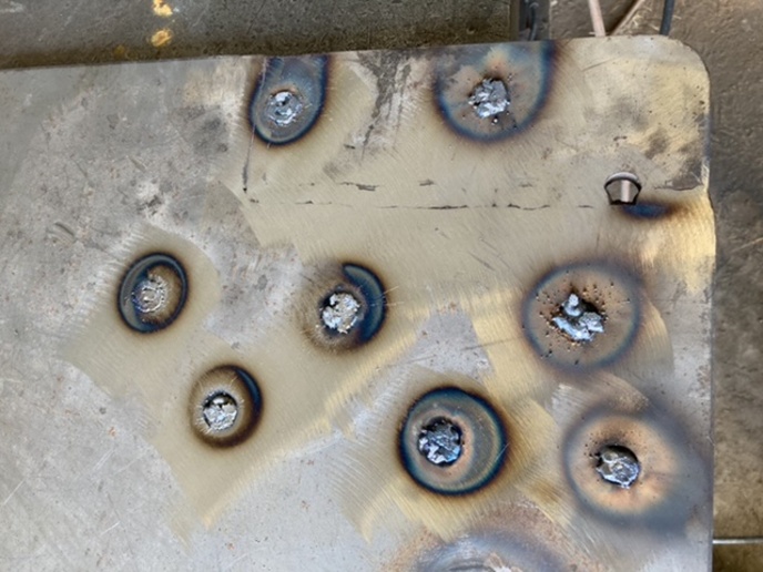

Heres welding the holes shut on the top side. I put a piece of aluminum under it and then filled the holes.

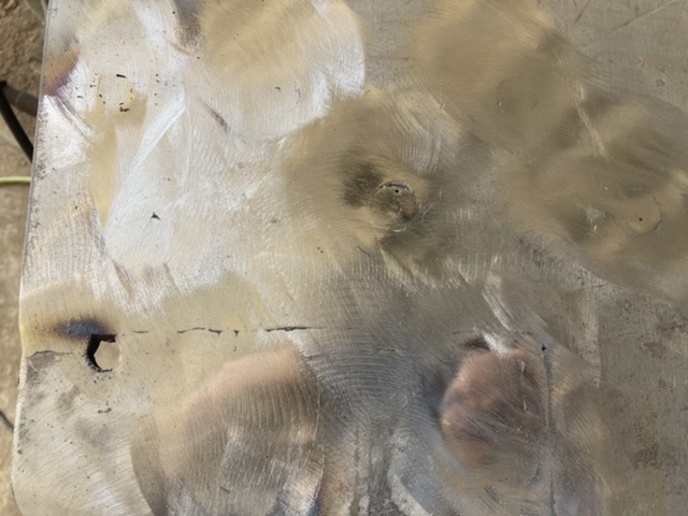

This is the back side after turning it over and finished welding the backside and grinding it smooth. Ill find out tomorrow if I can twist the frame enough to get it close.
