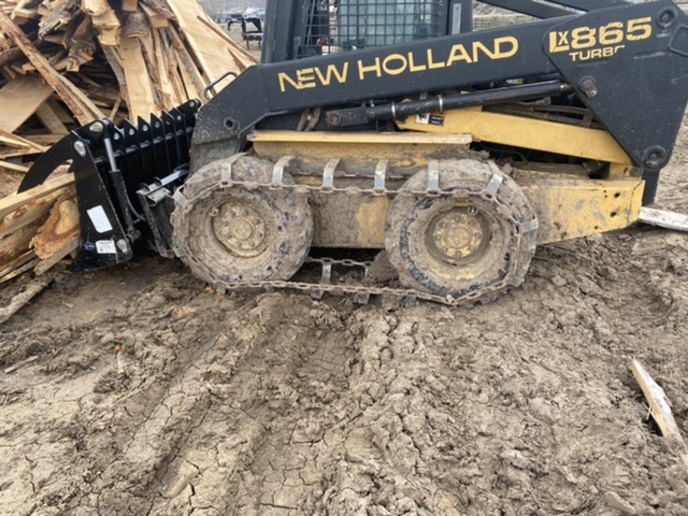

Skid loader died at the sawmill . Gear sheared off the flywheel that drives the hydraulic pumps . Seen it happen a lot years ago they had an update on them because the bore in the gear was made to deep and the bolts wouldnt tighten
