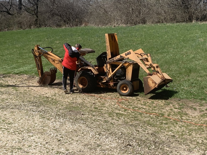

I posted about bringing this little tractor home last week. Today
we started looking it over.

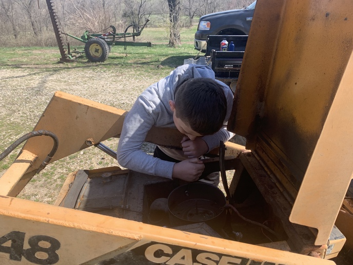

I had some things to do in the shop so son went out and started
cleaning some of the gunk off of it. Hes pretty excited to work
on it!

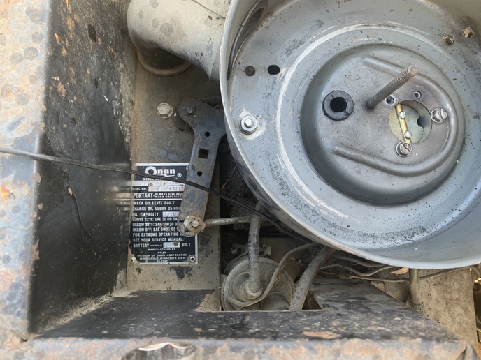

This is an Oman B48M engine we our working with. The story
we have is that it ran when parked, and its been sitting for 10
years. The first thing we noticed is a missing air cleaner screw
right by the throat of the carburetor. Fortunately it appears to
just be missing and didnt make it into the engine. I see a lot of
corrosion on the butterfly in the carb so Im figuring on getting a
gasket set and opening it up. Im sure it needs cleaned.

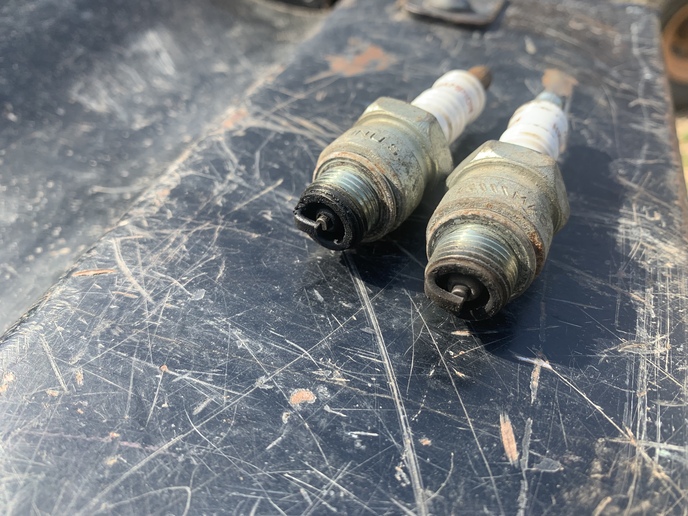

Son got the air filter off while I took the plugs out.
Heres a picture of them. If you can read plugs please tell me
what there saying!

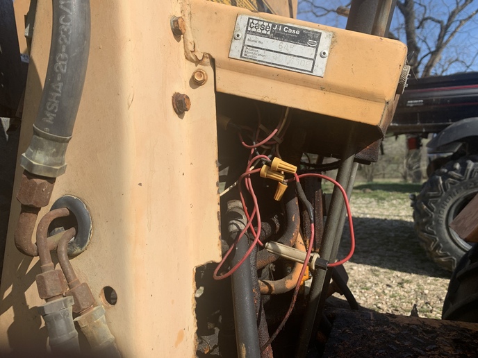

This has the usual funky wiring a lot of old forgotten machines
end up with. Its also missing the battery ground cable for some
reason. If we can get it running it will get a rewire for sure. It
needs a set of points as well. The engine doesnt appear to have
