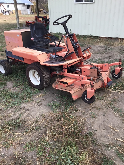

A friend gave me an old Gravely mower that had been sitting for almost 20 years, parked because its Yanmar 22 HP diesel had zero compression. I found the rings seized in the pistons, but cylinders in good shape. I used a dingleberry hone, installed new rings and gaskets, and it runs like a new one. At 5 hours there is still a puff of blue smoke at times, but I have no doubt it will do its job well.
