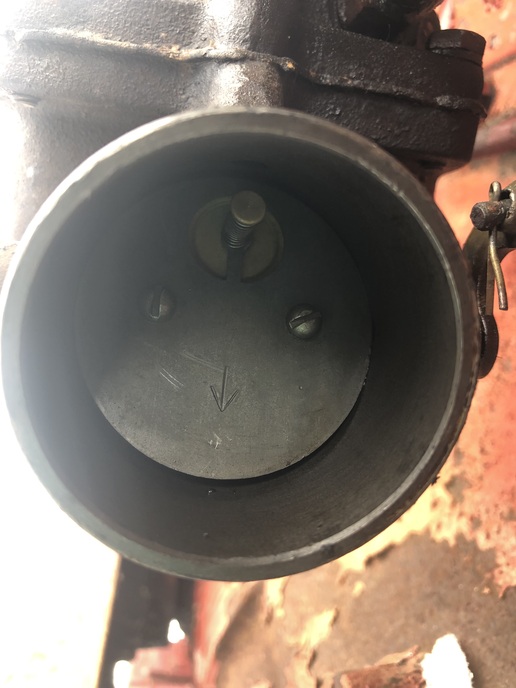

well you are half right ,... the arrow goes to the bottom. valve at the top. i had to inspect mine as to see which way the arrow goes. as i
knew that the valve has to get sucked open from the vacuum.
