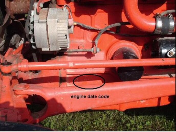

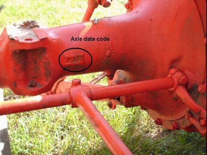

Look on the rear axle and engine and tell us what these numbers are. (see picture)
From this we can date the tractor and see if it fits the 1801 or 4040 time frame.
From the pictures you have posted (front grill) that is either a 1801 or 4040 with a transmission transplanted from a 640.
