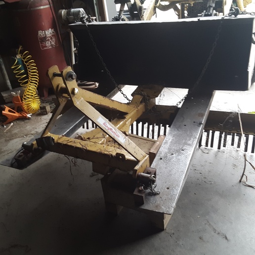

My bucket

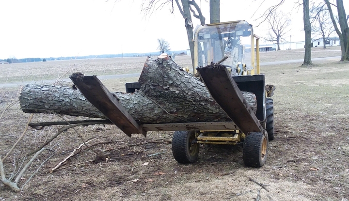

isn't a quick disconnect. I have no choice but to make my own forks. They do everything I need,
Made mine using 7 inch used channel.
Strong enough to list this log.
You need rear ballast if you
want to lift heavy things to take weight off front wheels and axle.
