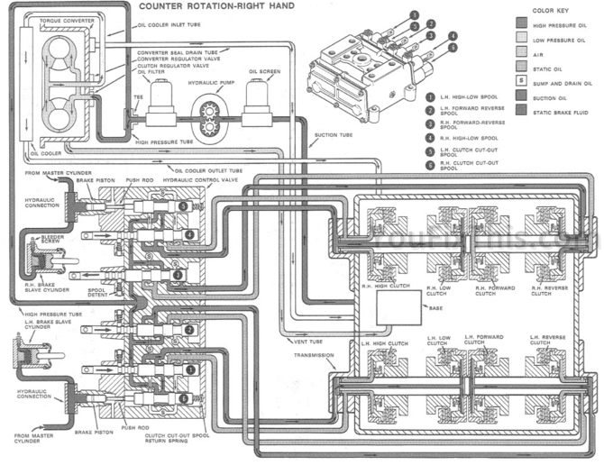

My dad has a Case 450 crawler front end loader. Sometimes when you first start it, it takes a while for the torque converter pressure to get high enough to move.
I was just wondering if someone could explain in simple terms how the drive train of one of these crawlers work? There is a cylinder hydraulic pump and a drive-train hydraulic pump right? Also, is the torque converter like a hydraulic-powered motor, or something else? It appears that the control levers are just hydraulic spool valves that engage different hydraulic clutches for high/low forward/reverse. But I don't really understand what the torque converter and hydraulic pump do? In an automatic car there isn't a hydraulic pump for the torque converter right? I found a diagram online that appears similar to how the Case 450 works and included it below.
