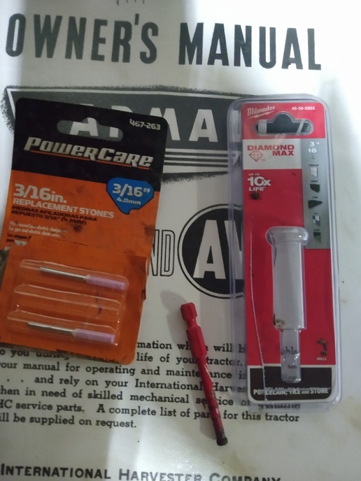

Yeah, right. 3 broken head bolts in a cub last week. Drilled first one stuck an EZ out in there, didn't even twist it hard, snapped off..... Hours later we got it out. Second time that's happened, wife threw the rest of the EZouts in the recycling bin. BUT, it is an awesome feeling when you get those broken bolts out!
Used these to remove the extractor
