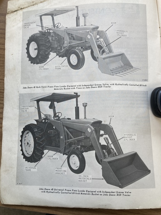

The manual for my 48 loader says the 48 Universal Frame Loader is designed for the 460 amoung other IH tractors and JD two cylinder tractors. The 48 Quick-Tatch loader only lists New Generation JD tractors. Sounds like you may have the Quick-Tatch instead of the Universal Frame loader which pushes against the rear axels.
