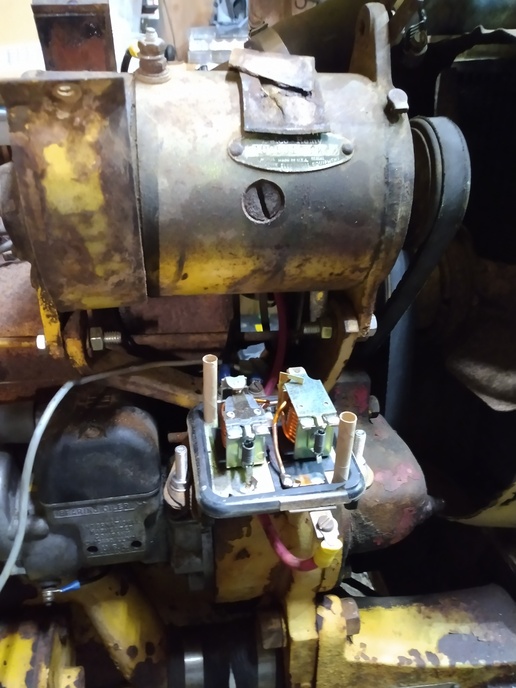

6 volt cub issue
Posted by grandpa Love on February 21, 2022 at 15:00:22 from (71.14.19.222):
Generator will run like a motor when I hot wire it. Voltage regulator looks almost new inside. Battery doesn't show a charge with a meter, new volt meter doesn't move either. I tried running a wire from F post to ground, supposed to by pass regulator?? That didn't do anything either. Tractor has a mag so pulling cable off battery doesn't tell you if it's charging..... Any ideas? Tried 2 different voltage regulators.
