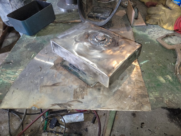

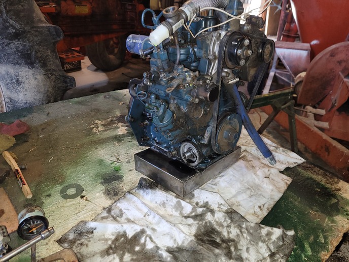

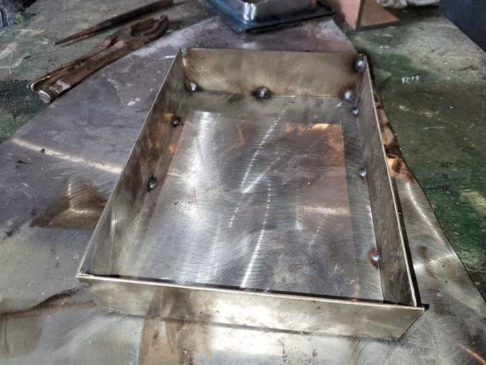

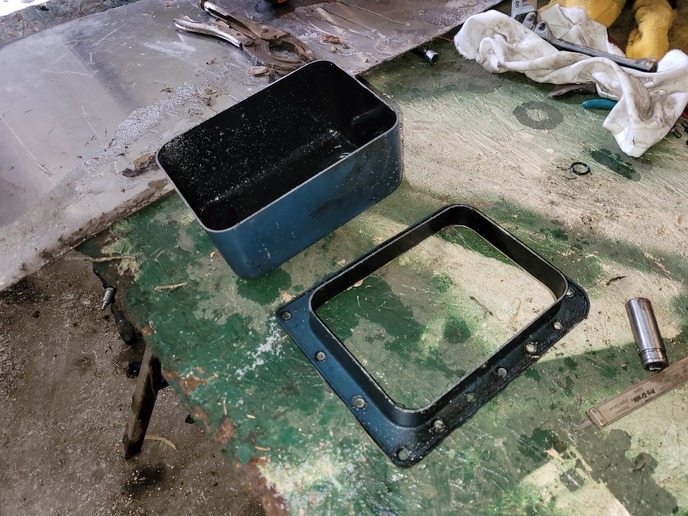

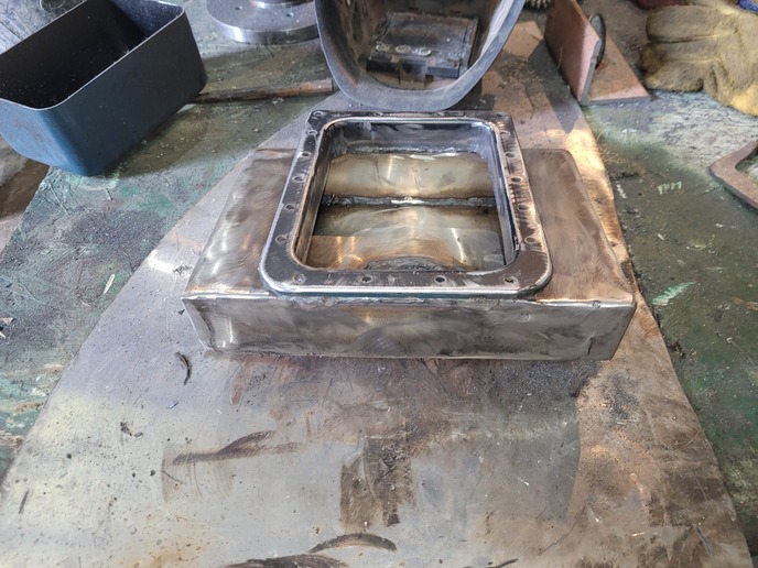

Started on the engine swap in my skid loader this weekend. Had to shorten the oil pan 3 to get the crank to be at the right hight. To keep the oil volume as close as possible I made it 4 wider. I used some off the stainless steel from that bulk tank I scrapped a while back.

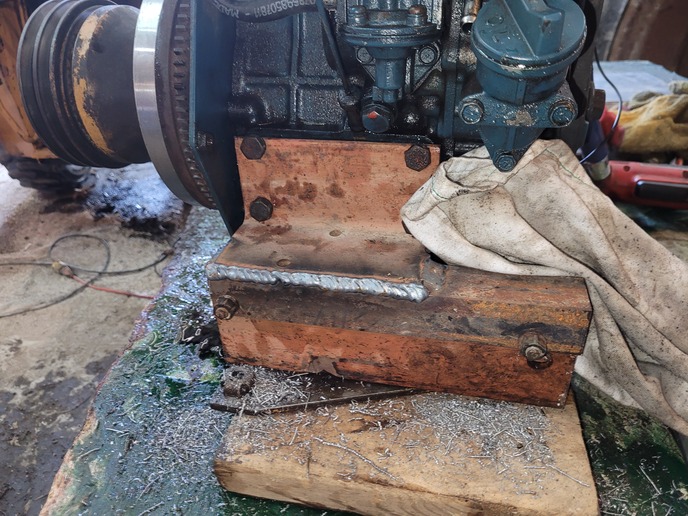

Next was to make the motor mounts. That was more complex than I expected because I had to get out around the pan, then back under to get mounted to the base plate. It also had to bolt together so it could come off. So I started with a 3 x 1/4 angle on the motor and another under the pan. Then welded a smaller angle to the engine angle so it could bolt to the bottom angle, which is bolted to the base plate.

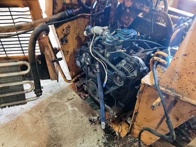

Here it is in the loader.

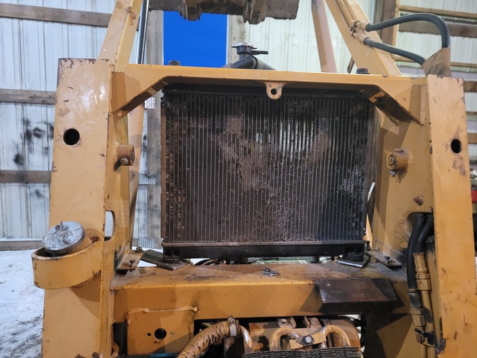

Next was the radiator. I originally thought it would go on the door, but that didn't work. And putting it right behind the motor wouldn't work because you would have to remove it to get to the oil filter and such. So I put it above the engine and behind the cab.
