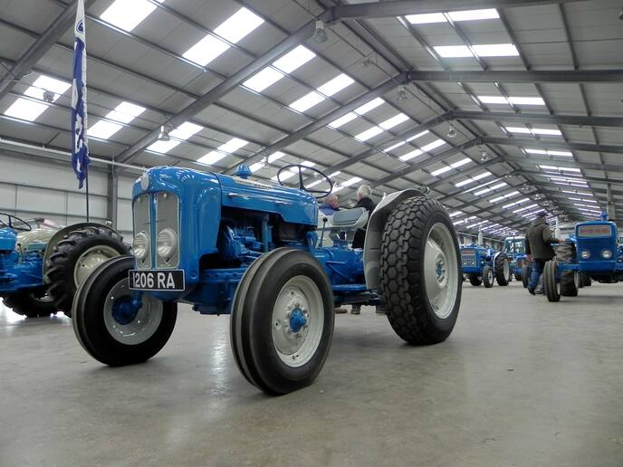

Could be a Dexta or a Super Dexta as the serial numbers ran together in tractors
built after 1962. The engine number on the block, up near the head join will be a
more positive indication on what you have.
Super Dexta

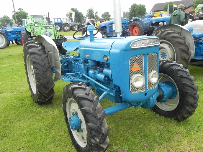

Dexta
Do not worry about the 4WD, just to illustrate that the nose cones are a different
shape. But these tractors around 60 years old so many parts could have been changed.
