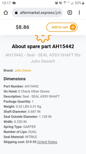

Here are the specs on that JD AH15442 seal that I mentioned.
