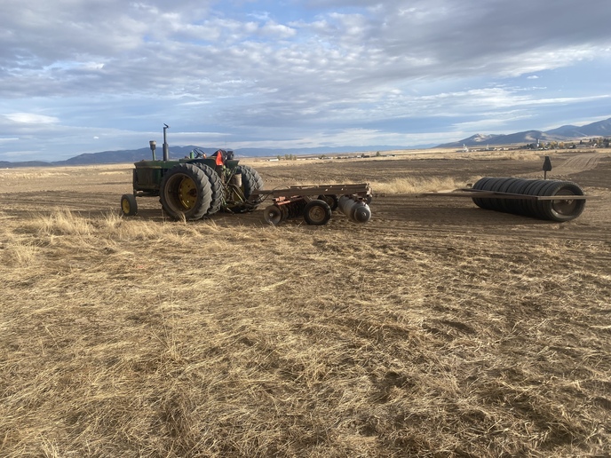

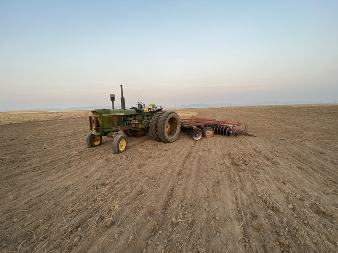

I pull a 370 international 14 feet wide with either my 3020 or
my 4020 You dont have enough weight or enough tractor to
pull that big of disk my 3020 weighs 10,000 my 4020 weighs
12000 pounds both have duals . If you had duals and a lot of
ballast you would have a better chance
