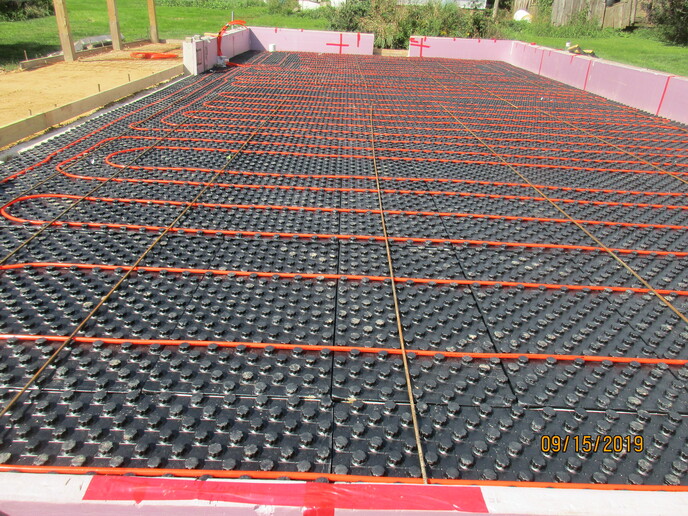

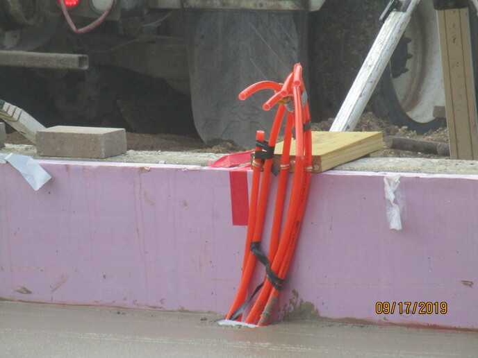

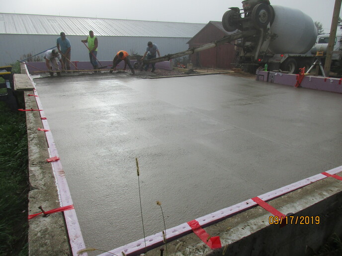

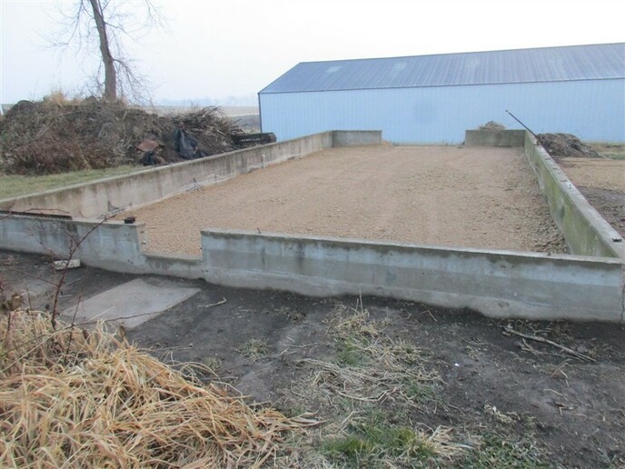

I am building a shop on an old 24' x 48'chicken house wall foundation. I put 2 foam with knobs on it for in-floor heat with 2 zones. One zone will be 24' x 16' work area with a loft overhead and the other zone the rest of the building. I have not gotten the building built. The tubing was relatively low cost and I would have put 2 of foam board under it anyhow so I'll find out if I like it or not. After the concrete is pour it is hard to go back.
