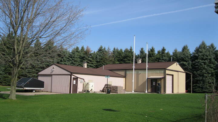

If you have natural gas or propane, you should really check out radiant tube heat. It is easy, efficient and cheaper. Very good at reflecting the heat down and warming the floor. I've had it in both my barns since 2002. The big barn (30x48x12) is uninsulated and will still get to 55 in 10* weather. The little barn is insulated and I keep at 45*. It will heat to 60* in about an hour.
