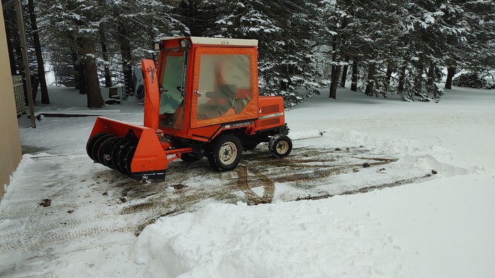

Not apples to apples, but kind of is. I can run this front pto at 1100 rpm or 2500 rpm. The tractor is only 20hp but will run a 60 mower all day in heavy grass in the 2500 rpm. If put the blower in 2500 rpm, it will throw 3 inches of power to the next county as long as I creep along. Move any faster, and it dies. I can blow 12 inches of snow until the cows come home in 1100 pto. No matter what you do, in my experience, running the tractor at less than full throttle under a load just doesn't work. Snow blowers are a load.
