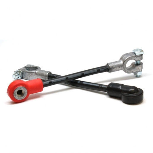

I have used what you pictured before. I replaced the bolt with a 316ss bolt and sprayed it all with that red stuff.
But where I used those adapters there was plenty of room. You need to be careful that the hood or something else is not too close to those vs the side mount battery.
Attaching the side mount cables..... There is tight and then there is too tight and you strip the lead threads.
You might look at using this style to get from center of battery.
