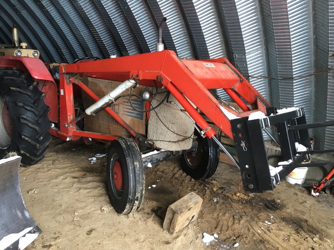

Actually front end loader maintenance. The left side bucket cylinder has had a slow leak for several years. I've had them off and at a hyd repair shop at least once but one cylinder would not last long before the shaft seal was leaking oil again. Finally decided to go for new cylinders. Princess Auto Shur Lift cylinders are cheap Chinese made but I've had good luck with the one I put on the JD 146 loader a couple of years ago so hopefully these will be the same. Tried moving a few bales with it and the new cylinders handle it fine with no more leaks.
