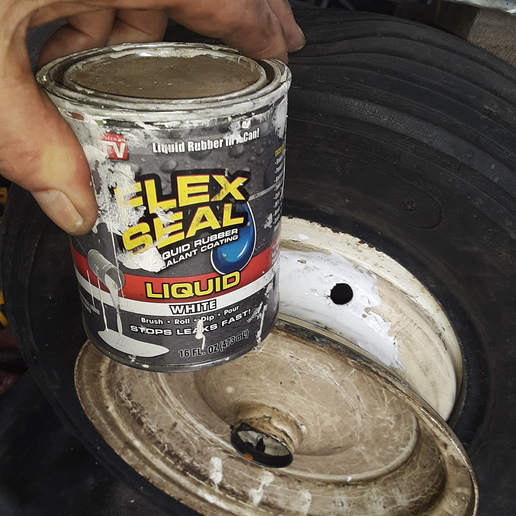

The tractor shop I use had no problem with slime.
They even install their own version. It's water soluble.

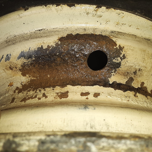

Air will also cause rust. Look at how much water comes out of your air compressor.
This old lawnmower rim had a tube in it. The rust caused my tube to leak. I cleaned up the rust and coated it with what my tractor shop
recommends.
Then installed a new inner tube.
