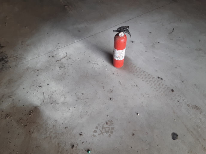

FIRE EXTINGUISHER is without thinking.

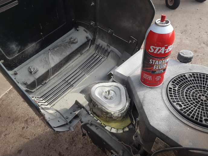

This morning I used starter fluid to wake up an engine that has been sitting for months.
I'll never spray starter fluid on the air filter again.
The engine had a hiccup and caught the filter on fire.

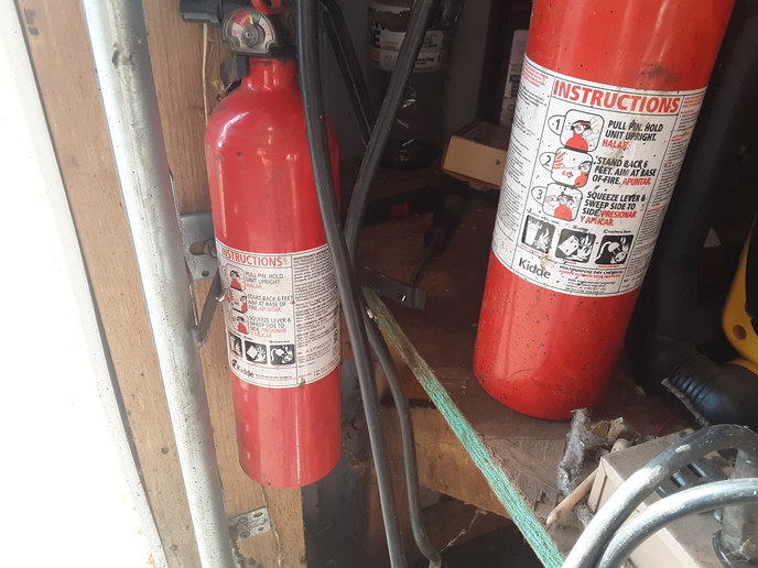

I have a spare filter and a spare fire extinguisher.
The fire extinguisher was only a few feet away.
Lesson learned. Remove the air filter and know where your fire extinguishers are.
