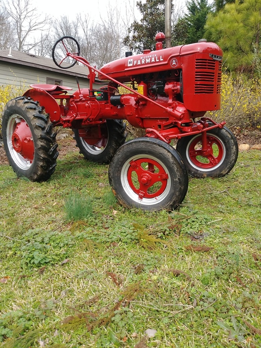

We cleaned this A for 3 days. Purple
power, hot pressure washer. Dawn dish
soap, hot water, wire brush, scraper,
purple power, hot water..... Let dry.
Wipe down with mineral spirits on a
rag. No primer on 99 percent of the
tractor. Brush painted it. 2 good
coats. Then mix a little thinner in and
do another coat. Good hot , sunny day.
Sheet metal was stripped to bare metal,
several coats of spray on primer. Then
short nap foam roller. 2 coats, then a
thinned coat.... It's Glossy! And has
held up great. Rust Oleum IH Red. Took
less than a gallon. Around 30 bucks.
Cheap paint brushes from harbor
freight. Rims were brushed rust oleum
silver.
The cleaner you can get it the better!
