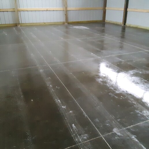

Possible the ground is frozen.
Calcium cost me about 6 to 7 dollars extra and hot water about the same.
This is a pic a day after.
My finisher applied cure and seal.
Some predicted my concrete finisher didn't know what he was doing. Mt floor was pot down in January 2020, temperatures about 30.
To date my 5.5 inch floor hasn't cracked.
