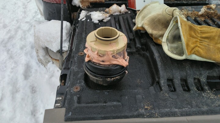

9 below here and two jelled up dorfs . 911 got the one going the other one was actually jelled . I treat the bulk tanks in the fall and all the equipment gets a triple dose about the end of October. One year we had 15 below in the middle of October treated the tractors but not the truck and it froze up idling doing morning chores . Both dorfs had double doses of Howes . I wish I knew where all these unrepeatable fuel suppliers were . I run straight number 2 all winter with up to triple dose of power service no problems to 40 below zero
