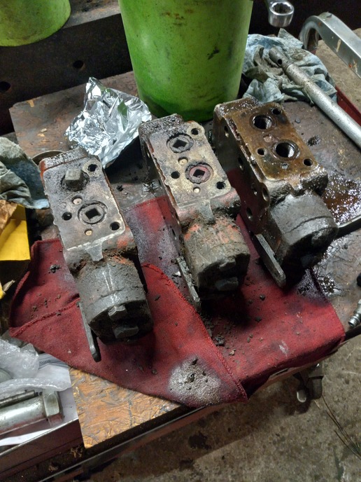

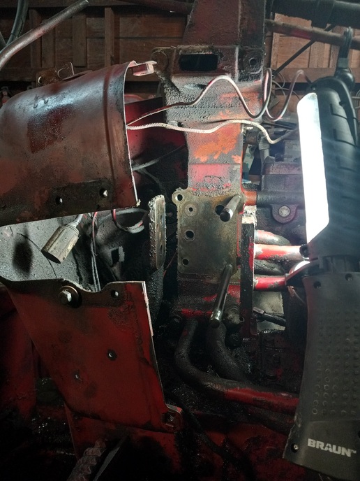

I've been working on the hydraulic leak on the 300. We removed all of the sheet metal so could get a good look at what's going on. The center and inside valves were leaking only from where the bottom cap bolts to the valve bodies. Everything else was dry. I obtained the O-rings that are between where the bodies press against each other and the rings for the bottom caps. What would be the harm in letting sleeping dogs lie per say on everything else being it's not leaking ? I am going to replace the o-rings where the steel lines bolt up.
