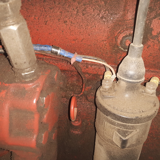

Do you have the OEM square pump?
The round pump is an upgrade,
My jubilee has been upgraded.
There's a plug on top to bleed the round pump.
If I can find the pic, I'll post a pic of the plug. I replaced the plug
with a pressure gauge.
This pic shows the coil and the place where the plug is located. The silver thing
Is the damper for the pressure gauge.
