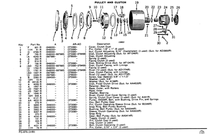

Re: John Deere A clutch
Posted by MSD on December 21, 2021 at 06:29:45 from (63.153.181.96):
In Reply to: John Deere A clutch posted by Midwest farmer on December 20, 2021 at 19:01:57:
There is no seal on the clutch pulley. One on the flywheel side that is available from Deere if that is the one you mean. Change the bolts for sure, maybe the pins #28. Also there is a pin #21 in the pulley part itself. We usually bore and put a bushing in #24 to tighten that up. Makes a huge difference in how they work.
