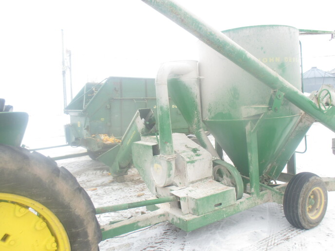

I have 2 John Deere 400's. They are a good grinder but are known for gearbox problems and parts are no longer available. What happens is the seal on top the box wears and lets feed fines get into the gearbox. After awhile you get a cake mix and finally concrete. I change gearbox oil every year on mine just to keep a check on them. I had a NH 352 for years and all NH grinders are very good machines. Mine had a short unload auger so I replaced it with the Deere to reach my feed bin. If I were buying today it most likely would be a NH 353 or 355. Tom
