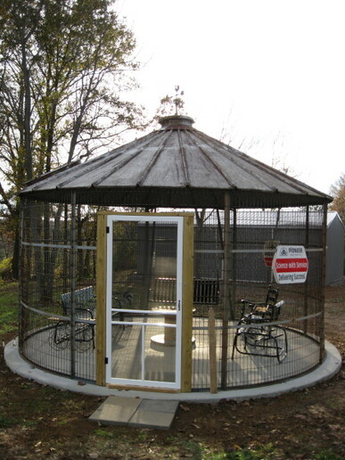

My son bought an un-used ear corn crib and moved it about ten miles, then converted it to a gazebo. We tried raising the roof as one unit, using a car tire/wheel in the center, and lifting through the center with a jib boom on a front loader. I could lift it with my JD 630 and 45 loader, but it wanted to fold, so we backed off and got a sheet rock lift in the center, with some hillbilly modifications, and after a few adjustments got it in place and looking good. He only used the bottom half - there was another section above the one that they used, but they didn't want it to be that high. His wife is proud of it, and that was our ultimate goal. Here's a picture of the finished product;
