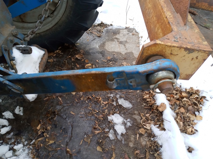

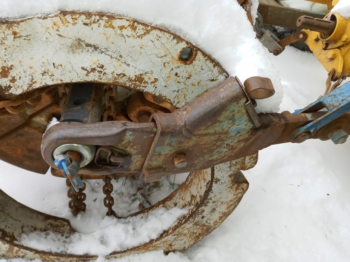

Ford put two different styles of lift arms on the 3 cylinder 4000 chassis tractors.
Most of the US built all purpose/ag models came with what I call the crab claw style. These were very heavily built. First photo.
On the Antwerp and Basildon built tractors and the US built Industrial models you will more often see a Much lighter style lift arms which are just straight. Second photo.
Both styles have changeable balls so you can run either cat I or cat II implements.
If you have the lighter style you might swap them out for the crab claw style.
If you are bending the crab claw style you are abusing the heck out of your tractor and definately need to follow Janicholson's advice.
