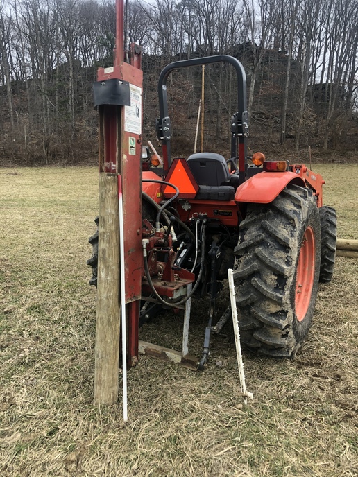

By the way I love my shaver. Thing is so much better than tamping posts! Just make sure to hook up the drain straight to the reservoir and lube it up good. Wouldnt be bad to have a replacement set of springs on the shelf. All the manuals are online from shaver. Once you have part numbers from the manuals, Ford distributing has all the parts online.
