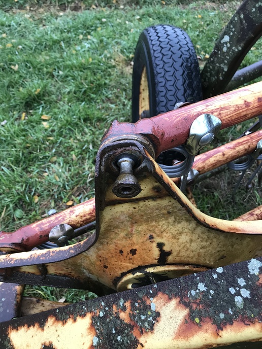

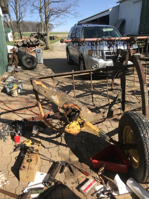

I spent last winter rebuilding portions of my NH 256 rake. One of the tine bar washers broke out and the
bearing shaft quickly burned thru the spider hole, wallowing it out. The gearbox bearings were shot and I
replaced a couple of tine bar bearings. Believe it or not the rake ran fine on the bad bearings but I just
decided to replace everything not in very good condition. Should go another 30 years now. No
exaggeration.
