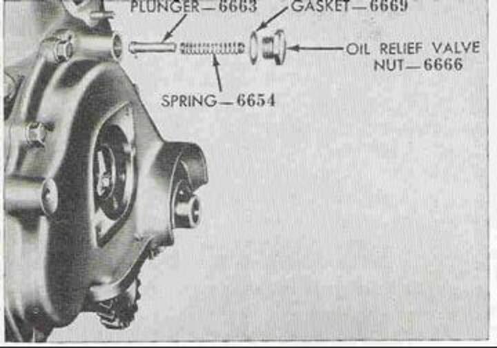

Take this out and see if the spring is broken, or crud
under the valve so it cant close. But my gut feeling
is that you wont find anything wrong here. Sure is
worth a try though.
